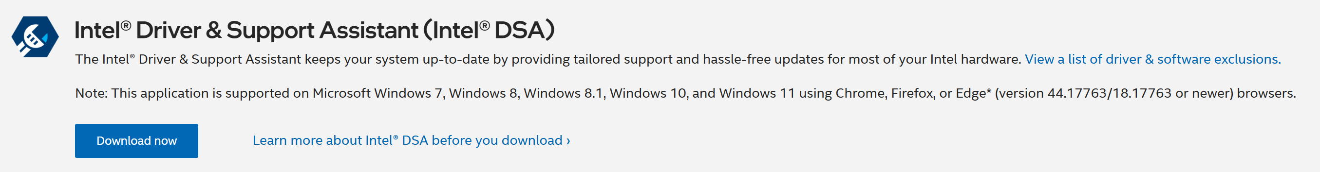

      Intel Driver Update Methods:
    Officially provided driver packages do not update in real-time. After a device has been in use for some time, the driver version may become outdated, and the associated bugs may accumulate. This necessitates manually upgrading to the latest drivers. Below are several primary methods for updating hardware drivers:
    The GPD BOX involves Intel drivers including the integrated GPU driver, chipset driver, Wi-Fi, and Bluetooth drivers.
    Please visit the following page:
    https://www.intel.com/content/www/us/en/support/detect.html
    Download and install the Intel® Driver & Support Assistant. Note that this utility is not a driver itself, but it can automatically detect the driver versions for Intel hardware in your system. If any version is found to be outdated, it will connect to the internet and update them accordingly.

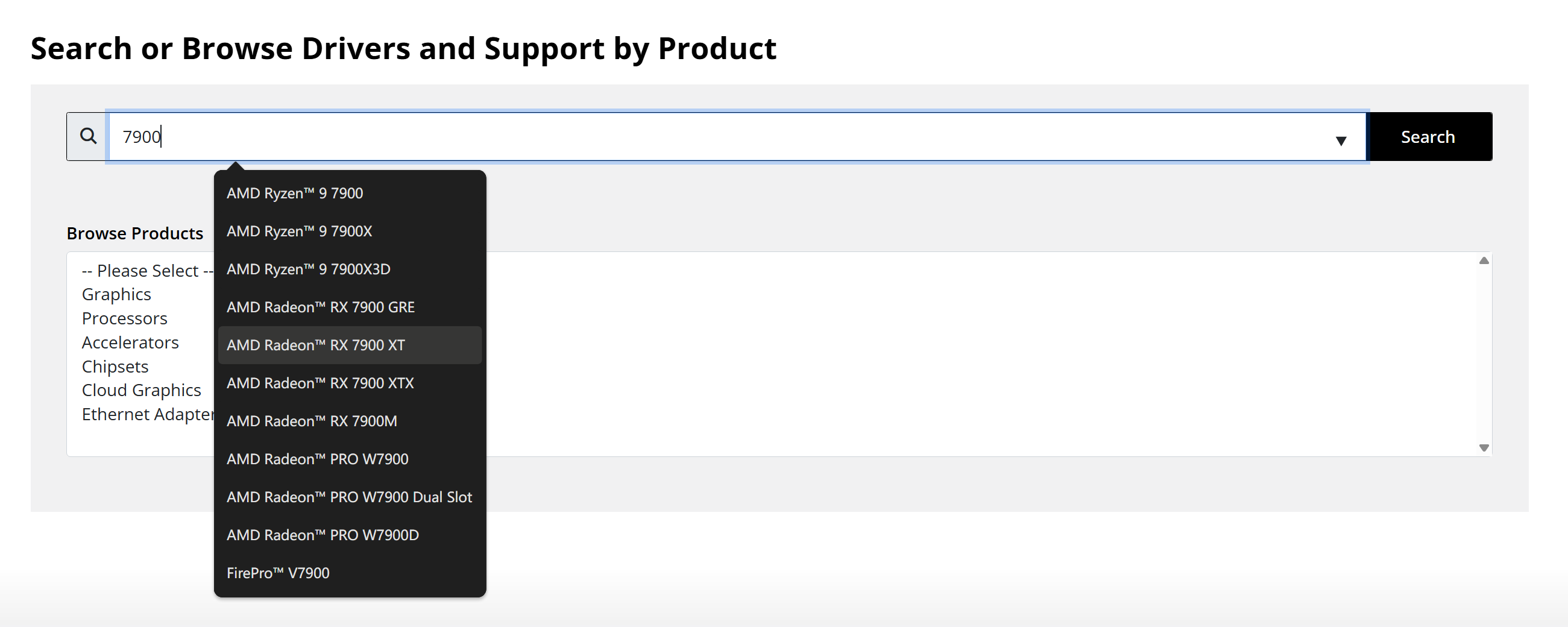

    The AMD official driver download page:
    https://www.amd.com/en/support/download/drivers.html
    Enter the corresponding graphics card keyword, select your graphics card model, and finally click “Search”.

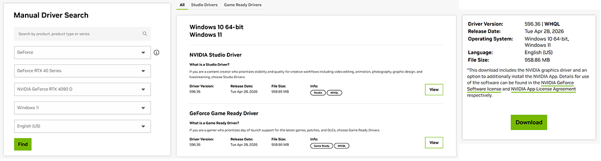

      NVIDIA Driver Update Methods:
    For GPD BOX processor devices, NVIDIA hardware is only accessible when connecting to the GPD G2 via MCIO or USB4 v2.0.
    https://www.nvidia.com/en-us/drivers/
    Sequentially select your graphics card series, model, operating system version, and language, then click “Search”. On the search results page, click to view and download the driver.
